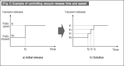

・To avoid the glass substrate fractures by the shock of vacuum release, it is effective to adopt the vacuum suction control design where the initial vacuum release occurs gradually in order to alleviate the shock from the release, followed by the time and speed control method until the release holes are fully open. (Fig.1)
![[Fig.1] Example of controlling vacuum release time and speed [Fig.1] Example of controlling vacuum release time and speed](/tt/en/lca/520_01.gif)
