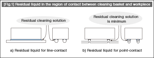

- To prevent leaving the residual cleaning solution in the area where the cleaning basket contacts the workpiece, it is important to design the cleaning basket so that it contacts the workpiece at multiple points without touching the whole surface (Fig.1).

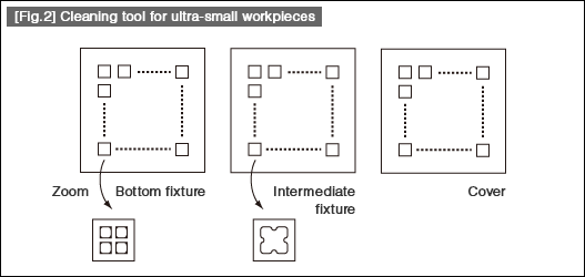

- Oscillation by ultrasound may cause the workpiece to chip if the workpiece is in contact with the cleaning basket and/or the cleaning fixtures. Therefore, the R-shape design is recommended for the corner area and the contact point of the cleaning basket and fixtures (Fig.2).
