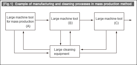

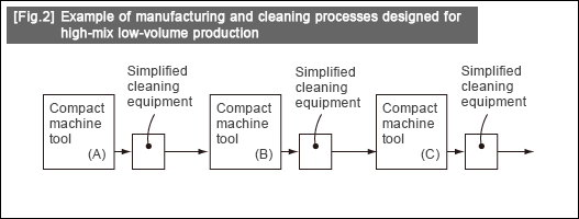

・For the mass-production batch manufacturing system using large machine tools, the batch processing by a large washing machine was also adopted for the cleaning process (Fig.1). For the high-mix low-volume production, the washing machine should be smaller and adjusted for smaller lots (Fig.2).
・For the one-piece flow production and the cellular manufacturing system, the goods are processed in synchronization with the previous process and the subsequent process (in the same pitch.) Therefore, such tasks must be performed in the optimum environment and the equipment should be designed in the specifications (appropriate size, capacity, etc.) eliminating inefficiency.In other words, small machine tools instead of the large-sized ones are used in these methods; the machining work itself will also be different.This means that the cleaning process should be adjusted accordingly, such as adopting a small washer, so that the machine operators can clean the products whenever they have done with the other tasks.
