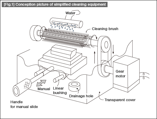

(1) Specifications of simplified cleaning equipment suitable for smaller lots
1) Equipment size
The machine operator must finish cleaning using the manual or simple auto mode of the simplified cleaning equipment within the time required for the compact machine tool to finish processing the goods. Therefore, the cleaning equipment must be designed in a size that can be installed at a reachable location from the operator.
2) Cleaning quality
Even when using the simplified cleaning equipment, contaminants that should be eliminated in that process must be washed off consistently. Adopting an electric motor for driving the cleaning brush is recommended for achieving stable cleaning performance.
3) Workpiece transfer
To clean the entire circumference of the workpiece, the one-way transfer design must be adopted. To make the equipment lightweight, compact, and simplified, a simplified linear guide (similar to the linear bushing) that is manually operated is adopted for the mechanism in the conception picture. In addition, a simple auto method should work as well.
4) Cover
The ideal cover is transparent enough to make the cleaning status visible. If you adopt a shape and/or a material that prevents contaminants from being stuck in the corners or gaps inside of the cover, you will be able to minimize reattachment of the contaminants.

(3) Conception picture of simplified cleaning equipment
- Fig.1 shows a conception picture example for the simplified cleaning equipment, which is developed based on the proposed specifications of this equipment and the process design details.
