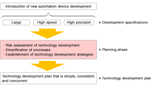

- In this case example, technological development is carried out by distinguishing the improved technology from the innovative technology as described in the following table.
(2) Development policy to realize opposite performance
- To realize the opposite performance in the concurrent engineering approach, it is essential to predict possible technological risks during the planning stage, while setting up a series of tasks assigned to related personnel from the planning, design, to production phase in a simple and consistent manner.
- To make this happen, the development management must be enforced in line with the development policies described hereinafter.
< Development policy example for adopting innovative technology >
- Minimize the overall risks by keeping the innovative technology involving unknown factors to 30% or less.
- Do not mix the improved technology with the innovative technology in the components of each development technology.
- Focus on the development of the innovative technology.
- To utilize the innovative technology into practical application, follow the consistent approach.
