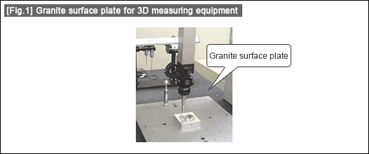

- It is important to select a structural material that is insensitive to thermal displacement and vibration while the deterioration with age is minimal.

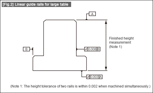

Description: Granite stones are those used in the surface plate of precision measuring equipment (Fig.1) and have the characteristics listed in (1). - Highly rigid structure (minimum deflection by the self-weight) --- See the next volume for details.
- Structural design allowing effortless precision adjustment during assembly
Description: After fine-polishing the granite stone, adjust the flatness, perpendicularity and parallelism by ultra-precision machining.
Fig.2 illustrates the sectional shape accuracy of 1.4m-long linear guide rails. The parallelism of the bottom reference plane against the top side is 0.003; the parallelism of the side reference plane against the lateral face of the rail is 0.008. - Selecting inexpensive standard components that are compatible with large equipment design
