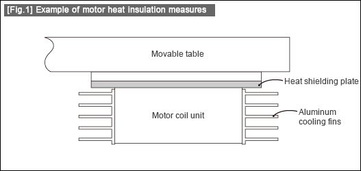

・In this case example, the components consisting of a linear motor and closed loop control are adopted for precision positioning control. An air cooling method is adopted as the heat insulation measures for the linear motor. The aluminum cooling fins having high heat conductivity (Fig.1) are installed at the motor portion.
・Since the motor coil unit generating heat is attached to the bottom of the moving table, the heat from the coil unit may cause the mechanical components to deform. To prevent the heat deformation, a heat shielding plate is inserted between where the motor coil unit and the moving table are connected. (Fig.1)
