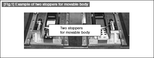

Description: Installing runaway stoppers (Fig.1) or a safety cover for the movable body - Select flexible and highly reliable wiring for connecting the drive actuator

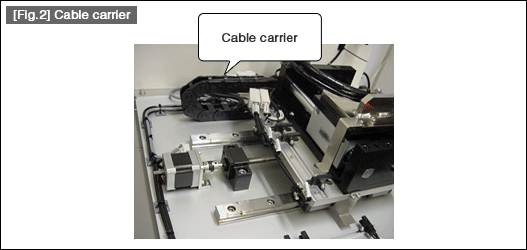

Description: For the mechanism used for repeated reciprocating motion, the actuator joint of the movable body is prone to fracture. Thus, selecting an appropriate cable carrier (Fig.2) is critical. If an inappropriate cable carrier was adopted, it hinders the cable carrier motion, which may degrade the positioning accuracy or cause cable disconnection or abrasion of carrier components (made of plastic). Ultimately, unexpected problems, such as the equipment contamination by wear debris, could occur.
![[Fig.1] Example of two stoppers for movable body](/tt/en/lca/D534_01.gif)
![[Fig.2] Cable carrier](/tt/en/lca/D534_02.gif)
