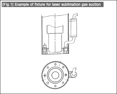

Previously explained in Vol. 535. - Countermeasure for laser energy decrease due to object lens tarnish caused by sublimation gas from the workpiece
Explanation and solution:
・Although the YAG Laser is used and this laser sublimes and thermally eliminates the organic thin film, tarnish formed on the object lens surface due to accumulation of sublimation gas causes the laser intensity to attenuate.
・An air suction mechanism was placed in front of the object lens as a countermeasure. (See Fig.1.)
![[Fig. 1] Example of fixture for laser sublimation gas suction [Fig. 1] Example of fixture for laser sublimation gas suction](/tt/en/lca/d537.gif)
