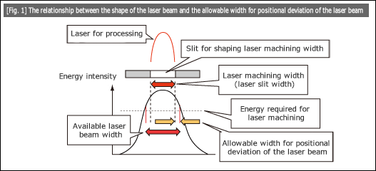

・Fig.1 illustrates the relationship between the shape of the laser beam and the allowable width for positional deviation of the laser beam required for maintaining machining quality.Fig 1 leads to the following formula for an allowable width for positional deviation of the laser beam:
・Positions of components on the light path needed to be re-adjusted for correct alignment because the beam position may shift over time due to ambient temperature changes, etc. in the light path system for laser beam.Optimization of the shape of the laser beam which allows an increase in the allowable width (W) for deviation in Formula (A) reduces positional correction for the beam and ensures continuous and stable processing for long hours.

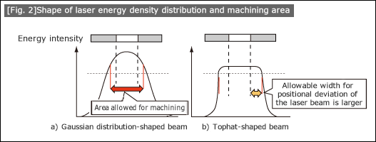

・This requires techniques for optimizing distribution of energy density of the split laser beam (such as techniques for optimizing from Gaussian distribution-shaped beam for tophat-shaped beam, as shown in Fig.2).
![[Fig. 1] The relationship between the shape of the laser beam and the allowable width for positional deviation of the laser beam [Fig. 1] The relationship between the shape of the laser beam and the allowable width for positional deviation of the laser beam](/tt/en/lca/D536_01.gif)
![[Fig. 2]Shape of laser energy density distribution and machining area [Fig. 2]Shape of laser energy density distribution and machining area](/tt/en/lca/D536_02.gif)
