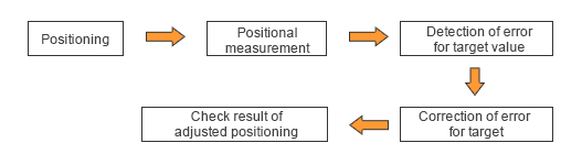

・Positioning precision consists of two errors, namely "bias error", and "variation error".
・The "bias error" can be corrected toward the target value using positional measurement and control.Generally, the error can be corrected by measuring the result of positioning precision at the initial positioning, and adjusting positioning to correct the error for the target position, etc.
・Suppose, for example, the required precision is +/-0.1 mm for positioning, it is preferable to select a positioning measurement sensor whose resolution (minimum read scale) is more precise than the required precision by one digit (measurement precision of 0.01 mm or higher).

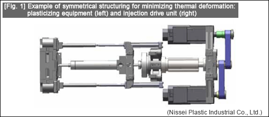

・In the precision machine tools, techniques for minimizing effects on machining precision from thermal deformation are introduced to avoid skewed thermal deformations by adopting a symmetrical mechanical structure.Fig.1 is an example of a symmetrical structured drive mechanism for injection molding equipment.
![[Fig. 1] Example of symmetrical structuring for minimizing thermal deformation: plasticizing equipment (left) and injection drive unit (right) [Fig. 1] Example of symmetrical structuring for minimizing thermal deformation: plasticizing equipment (left) and injection drive unit (right)](/tt/en/lca/d540_02.gif)
