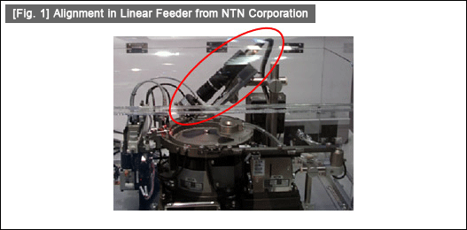

・Image processing, adopted as a countermeasure for troubles like positioning error, helps to measure the correctness of position and orientation of screw parts before the positioning stage, and to reject inappropriately oriented parts (Fig. 1).

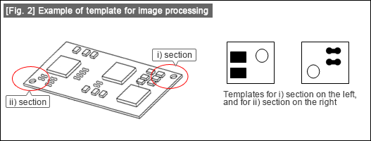

c)Register a template shape for inspection in advance as a pattern for orientation, circuit, etc., and apply it to positioning or inspection of scratches by checking it against the template (template matching) (Fig. 2)

・In the template matching technique, characteristics of shape required for recognizing the image of object are registered as templates for pattern recognition, which are used for precise positioning and orientation control for complex shapes, or determination of circuit pattern defects.
