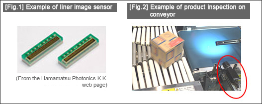

・Image sensors include a (1) simple photoelectric sensor, (2) liner image sensor (Fig. 1), (3) matrix image sensor, (4) pattern recognizer (Fig. 2). For applications of (3) and (4), various numerical calculation operations are introduced for pattern recognitions.

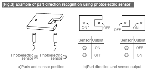

・Combination of some photoelectric sensors (phototransistor, photoelectric sensor, etc.) will make determination of rough profile, orientation, and judgment of front and back sides for the object under inspection possible (Fig. 3).

・Liner image sensors are often used for the case where objects under inspection are moving on the conveyor.Matrix image sensors, composed of photoelectric elements arranged in a matrix form, are applied in the inspection on the two dimensional plane.
