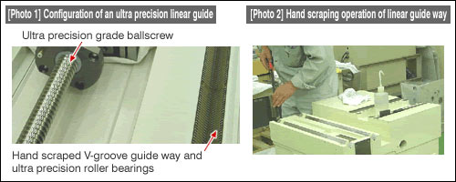

(a)About contacting slide guide
 | ・ | [Photo 1] below shows a representative configuration for a contacting slide guide for an ultra-precision machine. It uses a V-groove hand scraped by highly skilled operators and ultra precision grade roller bearings.
![[Photo 1] Configuration of an ultra precision linear guide [Photo 2] Hand scraping operation of linear guide way](http://www.misumi-techcentral.com/tt/en/lca/images/010_1.jpg) |
 | ・ | Moving body and the roller bearings are placed on the hand scraped V-groove, and repeated adjustments are made using a measurement instrument. |
 | ・ | This linear guide mechanism is driven by a ball screw. In order to negate any vertical errors that may be generated by the ballscrew deflection, the ballscrew nut is retained by parallel springs and only linear force is transmitted. |
