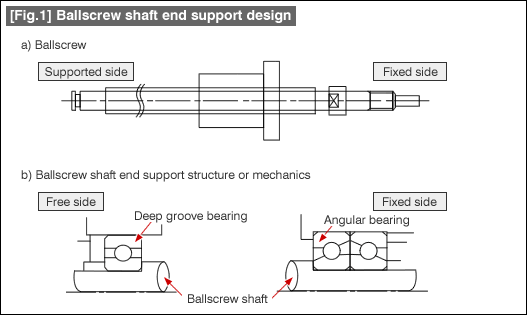

(1) Methods to support ballscrew ends
There are three ballscrew mounting methods: Fixed - Fixed, Fixed - Supported, and Fixed - Free. The most common is the Fixed - Supported method. Each method requires design considerations not to cause excessive moment loads and radial loads on the ballscrew shafts.
On the fixed side, the bearing's inner race is fixed to the ballscrew shaft with a slip fit, and the bearing's out race is solidly mounted to a support unit housing to eliminate axial movements. Angular bearings are used for radial and axial loads. On the free side, the ballscrew shaft is not captured in order to account for any heat related shaft expansion. (see [Fig.1])

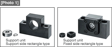

(3) Selecting the end bearings
For the reasons stated in (2) above, end bearings be different types and the end bearing holders will also be of different designs. In order to eliminate this necessity of designing two different bearing holders, MISUMI provides support units as standardized pairs. (see [Photo 1])
