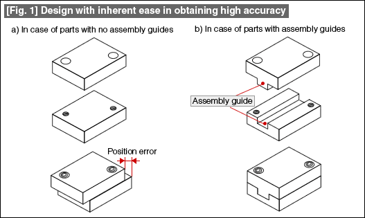

(2) What is a design that is easy to obtain accurate assembly? (see [Fig.1])
An adept designer would build-in the required properties (orthogonality in this case) into the design drawings. To do this, the designer needs to visualize the following.
The designer applies into the drawings the elements that induce accuracy in assembly based on the images 1. and 2.
![[Fig. 1] Design with inherent ease in obtaining high accuracy](http://www.misumi-techcentral.com/tt/en/lca/images/46_01.gif)
(3) Reason for embedding ease of assembly accuracy into drawings
The parts that require assembled accuracies are produced with machine tools capable of micron level accuracies over the length of the parts. Therefore, the parts can be produced with assembly guides offering built-in accuracies, eliminating needs for highly trained assembling personnel.
