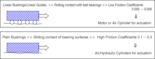

(2) About Friction Coefficient Differences
These differences are due to the differences in sliding methods (rolling motion or sliding motion). These differences will directly affect the selection of driving actuator.
| a) | Low Friction Resistance = Little Fiction force = Possible to drive with small motors = Rotary motion to Linear motion Conversion | |
| b) | High Friction Resistance = Large Fiction force = Requires large torque/force = Push directly with linear cylinder |
Cautionary Points on Usage
| 1. | The high friction coefficients affect driving actuator selections and operation heat generation. The plain bushings are not suitable for frequent motion at high speeds. | |
| 2. | Air cylinders are not well controllable for acceleration/deceleration velocities thus some soft-stop mechanisms such as shock absorbers will need to be installed to achieve high speed operations and vibration control. |

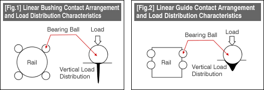

(3) Differences in Guide Accuracies
This parameter is mainly determined by clearances between the rails and bearings.
| a) | Linear bushings are used with round shafts, and operate with small amount of clearances such as "Clearance Fit: g6" or "Medium Fit: h5" | |
| b) | Linear guides are used as pairs of dedicated rails and precision bearings in "Slight Clearance (0~3 μm) or "Preloaded (-3~0μm). | |
| c) | Guiding accuracies of plain bushings are lower since they are used with shaft clearances larger than linear bushings. |
Bearing contact arrangements of linear bushings and linear guides are different. Linear bushings have Point Contact arrangement and localized contact pressures are high. Linear guides use rails with concave grooves that are shaped to fit the spherical shape of the bearing balls and the contact arrangement is a Surface Contact. Applied loads are distributed over the contact areas. The contact arrangement differences reflect on the load capacities of these systems ([Fig.1] & [Fig.2]).
