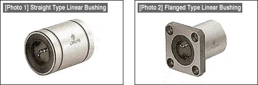

[Photo 1] is the Straight Type, and [Photo 2] is the Flanged type. The Flanged Type [Photo 2] has the following advantages.

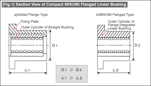

[Fig.1] is a graphical explanation of a MISUMI Flanged Linear Bushing. Adding a flange on a straight bushing will increase the housing diameter and length, but the flanged linear bushing is compact since the bushing and an outer cylinder are integrated into one structure. A compact design is possible while retaining load bearing capacity.

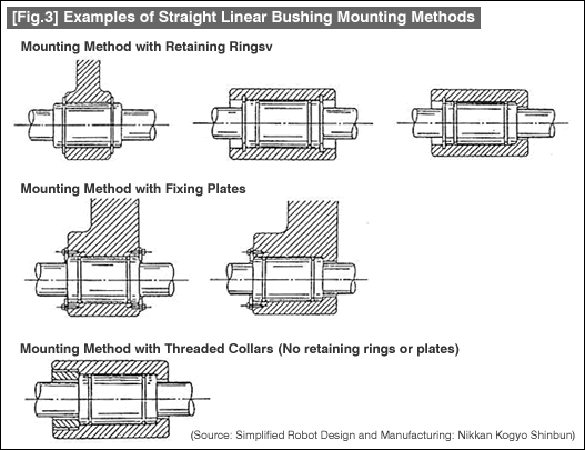

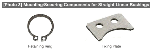

Straight Linear Bushings are mounted/secured using Retaining Rings or Fixing Plates. (See [Photo 3] & [Fig.3])
Linear Bushings" name="image" width="527" height="175" />
![[Fig.3] Examples of Straight Linear Bushing Mounting Methods](http://www.misumi-techcentral.com/tt/en/lca/images/079_zu3.gif)

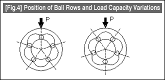

Linear Bushings have varying number of ball rows depending on types and shaft diameters. They typically have 4~6 rows of ball circuits and are placed in equally spaced angles. In horizontal motion applications, placing a ball row at 12 o'clock position (left illustration in [Fig.3]) should be avoided since the balls would have to bear concentrated loads.
![[Fig.4] Position of Ball Rows and Load Capacity Variations](http://www.misumi-techcentral.com/tt/en/lca/images/079_zu4.gif)
In the [Fig.4] with 5 ball row type, the load capacity ratio (Right divided by Left) would become as shown below. Therefore, it is recommended to mount the bushings as shown in the illustration on the Right.
