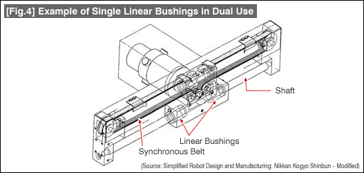

Therefore, load capacity and guiding accuracy can be improved by increasing the length of linear bushings. For this reason, [4] Singles (exclusively designed for dual use) are used for higher accuracy applications in some cases. ([Fig.4])
Linear Bushings in Dual Use" name="image" width="527" height="250" />
