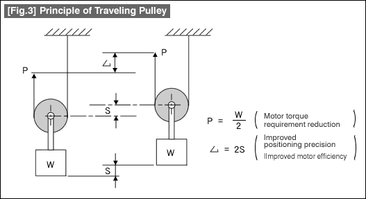

c) [Fig.2] is an application example for a single axis robot with following features.
| 1. | Widely spaced dual linear bushing guides for good load capacity and accuracy. | |
| 2. | Traveling pulley arrangement ([Fig.3]) is used for high motor power efficiency and good positioning precision. | |
| 3. | Lightweight and quiet operational characteristics from synchronous belt drive. | |
| 4. | Vertical inline orientation of the shaft and belt prevents the bushings from rotating, even for one shaft structure. |
![[Fig.2] A Structure Example of Improved Motor Power Efficiency and Precision Using Pulleys](http://www.misumi-techcentral.com/tt/en/lca/images/081_3.gif)
![[Fig.3] Principle of Traveling Pulley](http://www.misumi-techcentral.com/tt/en/lca/images/081_5.gif)
