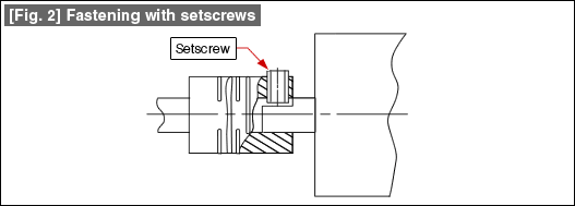

-Fastening with setscrews (See Fig. 2.)
![[Fig. 2] Fastening with setscrews [Fig. 2] Fastening with setscrews](http://www.misumi-techcentral.com/tt/en/lca/images/094_02.gif)

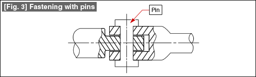

-Coupling with pins (See Fig. 3.)
![[Fig. 3] Fastening with pins [Fig. 3] Fastening with pins](http://www.misumi-techcentral.com/tt/en/lca/images/094_03.gif)
