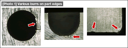

(1) About burrs on parts
The burr removal techniques were previously discussed in Vol. 289. Parts that are machine processed have burrs on them due to the elongating nature of the metals. (Photo 1)

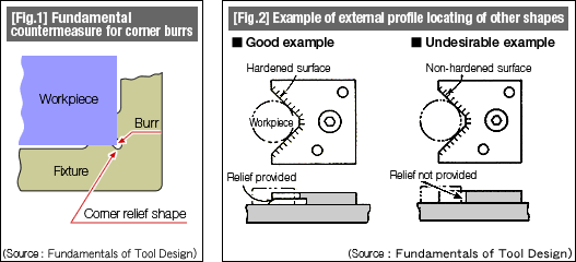

(2) When locating with external features
- There are burrs on parts not chamfered. Therefore some relief features must be provided for the corners.
- [Fig.1] shows the fundamental countermeasure for the burrs. Application variations of this would be to locate on external profile with pins, and other different shapes.
