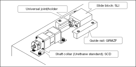

(2) Linear motion unit (Fore/Aft) construction example
The fore/aft linear motion unit can be constructed as an application variation of up/down linear motion units. But since the fore/aft units typically are required to move the base plate surfaces, slide guides are more often used rather than linear bushings.
(1) A simplified press unit with slide guides/slide blocks
The following procedures are the notable points on the guide rail and slide block assembly and adjustments.
| - | Locate one of the two guide rails as a datum guide rail (A). |
| - | Adjust the air cylinder parallel to the datum guide rail and fix. |
| - | Temporarily assemble the other guide rail (B) and the slide block (Loosely tighten the guide rails screws) |
| - | Lightly press the guide rail (B) against the slide block, and tighten the screws of the guide rail (B) while observing that the slide block moves smoothly without any play. |

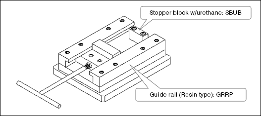

(2) Manual linear motion unit
