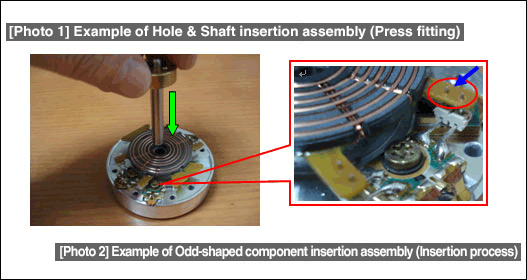

・Insertion assembly is a procedure to process the following operations manually, or by the use of fixtures/devices.
・Interference fits such as press fitting realize functionalities such as (1) fixing, (2) positioning, (3) orientation fixing, (4) force transmission.
・Clearance fit insertions are for, (1) positioning, (2) guiding, (3) joining pre-process, (4) joining.
![[Photo 1] Example of Hole & Shaft insertion assembly (Press fitting) [Photo 1] Example of Hole & Shaft insertion assembly (Press fitting)](http://www.misumi-techcentral.com/tt/en/lca/images/176.gif)
