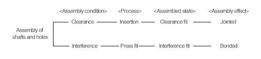

Assembly of shafts and holes can be classified into 2 types based on the dimensional relationships of 2 parts parts to be mated.
Here, the terminologies of press fitting that require forces.
[Table 1] Press fit operations and terminology explanations
Explanations of press fitting process
Press fitting is a process where 2 parts are press assembled with a targeted amount of interference between the shaft diameter and the hole diameter.
Insertion forces amounting the surface pressure and friction of creating the interference must be applied. The press fitting can be classified based on how these forces are applied.
Press fitting processes require some preparations with high levels of difficulty such as reliable locating and part holding of the components, but reliable bonding of the parts can be obtained without adhesives according to the press fitting forces applied.
