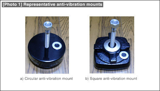

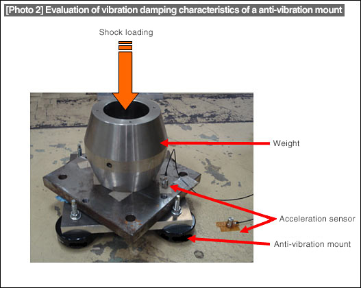

Anti-vibration mounts ([Photo 1]) are used to reduce vibrations on machines such as component insertion machines and press-fit machines, or in isolating external vibrations to the machines.
[Photo 2] is a frequency based evaluation of an anti-vibration mount. MISUMI anti-vibration mounts can be utilized for effective vibration countermeasure.
