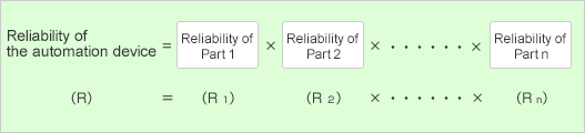

- "Reliability" is a technical term defined in the JIS glossary. It is defined as "a characteristic of a system, device, or component thereof expressed as a probability that it will perform its required function under the given conditions within the specified operating periods".
"Reliability" is expressed by a multiplication formula (series model) of the reliability of all the assembly components comprising the automation device.
Since the reliability decreases by the number of components multiplied, it is more effective to decrease the number of components than to increase the reliability of individual component.
Examples:
* The reliability of the automation device with 10 components (90% reliability) assembled is R = 0.910 = 0.35, which is extremely low.
* Improving the reliability of 10 components to 93%: R = 0.9310 = 0.48
* Decreasing the number of components to eight by eliminating two components: R = 0.98 = 0.43
* Even if the reliability of each component is 99.9%, the overall reliability will be calculated as R = 0.9991000 = 0.368 for 1,000 pieces.
* For the system design requiring 100% reliability, such as a space satellite, the parallel model will be adopted instead of the series model for its redundancy. -

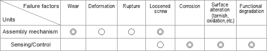

The table below shows the major failure factors for the assembly mechanism unit and sensing/control units (◎ indicates an extremely high ratio)
- As you can see from the above table, minimizing the number of components, especially the sensor components, is the important factor in designing a highly-reliable automation device.
- It is also important to adopt a design that is highly reliable and easy to maintain ("good accessibility" in other words) during the operating period.
