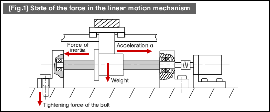

- A force applied to all the mechanical devices including the automation device has a point of application.
- In most cases, the mechanical devices are designed with the enhanced performance of assembly and machining work using this point of application.
- In the case of a mechanical device that drives at a high speed, the inertia force applies at the position where the acceleration changes.
- The machining and inertia forces are balanced with the reaction forces that work in the opposite direction. This is why the mechanical device itself is able to stand still in a stable position.
- The mechanical device must have the sufficient structural strength that is larger than the reaction forces.When you design a structure that is strong enough to overcome the reaction force, the strength must be guaranteed throughout the usage period of the mechanical device.

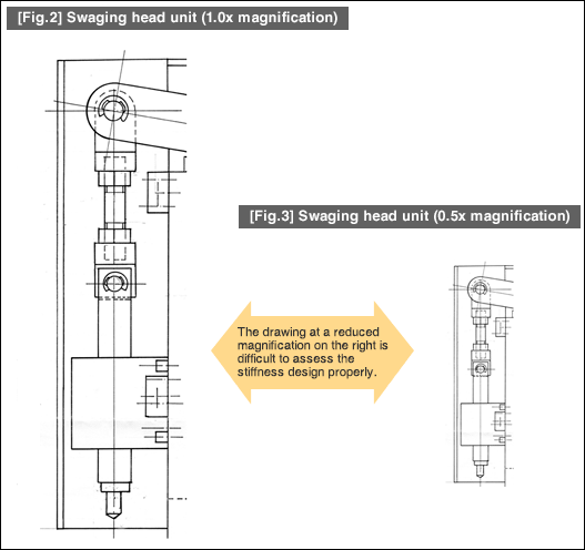

- To incorporate the stiffness design in the actual designing stage, create a drawing of a particularly important component at 1.0x magnification. It is important to view the drawing so that you can avoid the intuitively weak structure when you design the detailed shape (See [Fig.2]).
- We tend to magnify the drawing of a complex component in the design process. However, if we do this, it is important to know that using a different magnification compromises our intuition to assess the stiffness design accurately (See [Fig.3]).
