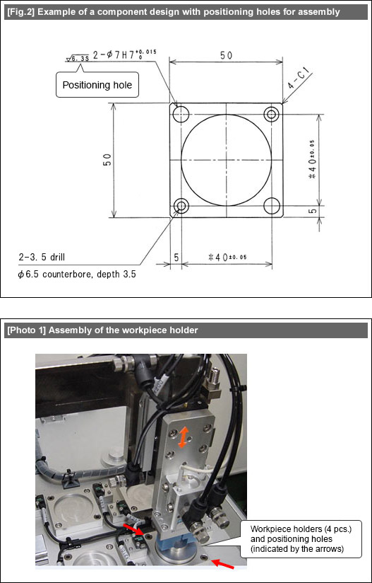

- [Fig.2] is an example of the assembly guide parts drawing (workpiece holder) using locating pins. This is a case example of the parts requiring the assembly precision to keep the workpiece in place.
- In this case, two of the four fixing screw holes can be used as a guide hole of the locating pins.
