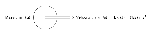

- The kinetic energy Ek (J) that an object with a mass m (kg) in motion at a velocity v (m/s) can be expressed in the following formula:

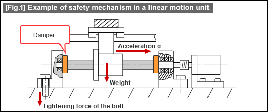

- In a linear drive mechanism, a movable body continues its movement while possessing kinetic energy Ek.
- In case of accidents due to a lightning strike or power outage that could suspend the operation control, it is necessary to incorporate a safety mechanism into a machine in order to avoid damages and injuries caused by the kinetic energy that the movable body possesses.
- Installing a damper on both ends of the linear guide is a common method of incorporating a safety mechanism into a linear driving unit (see [Fig.1]).

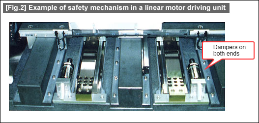

- When you install an actuator with little frictional resistance into a linear motor mechanism, designing a safety mechanism is especially important. In such a case, large-sized dampers are adopted (see [Fig.2]).
