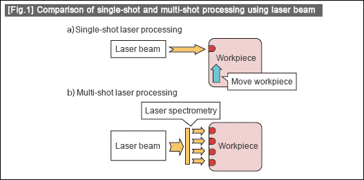

・To add several straight lines to a workpiece using the laser beam, there are two ways. You can use a single laser beam to irradiate multiple areas by moving the workpiece (Fig. 1a), or you can also shorten the processing time by splitting a laser beam into several beams to irradiate multiple areas at once (Fig. 1b).
![[Fig.1] Comparison of single-shot and multi-shot processing using laser beam [Fig.1] Comparison of single-shot and multi-shot processing using laser beam](/tt/en/lca/d535_01.gif)

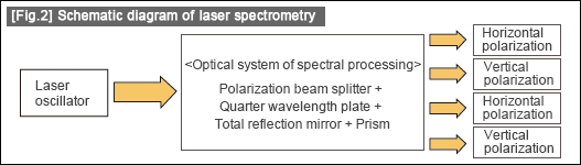

・To use multi-shot processing shown in b), it is necessary to adopt a technology that can equally distribute several laser beam components from a single source.
・The laser beam will be split into horizontal and vertical polarization components using optical parts, such as a polarization beam splitter and a quarter wavelength plate. (Fig.2)
