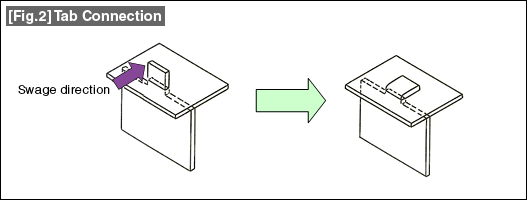

(2) Tab Connection
Used for connecting bent plates. A tab formed on one part is inserted into a slotted hole on another part, and the plates are connected together by the tab being (1) Folded, (2) Twisted, or (3) Crushed.
Fig.2 Tab Connection
Source:"Assembly Elemental Technology Manual", Nikkan Kogyo Shinbun Ltd.
